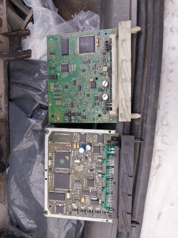

Elektronik arıza yoktur bence direk beyin çalınmıştır tahminimce
Sağolun...Keşke öyle olsa sorunu gidermek daha kolay olurdu 😁

Tesisatını fare kemirmiştir muhtemelen.

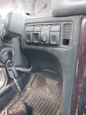

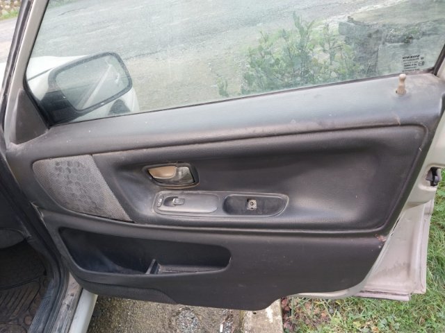

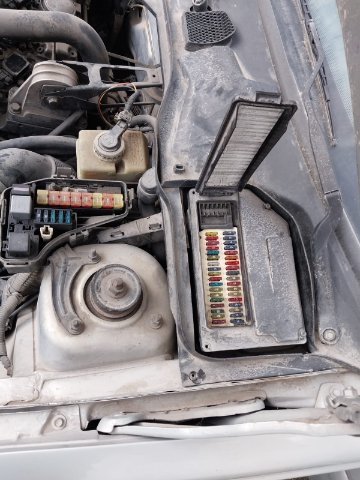

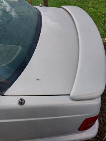

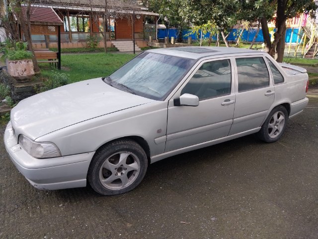

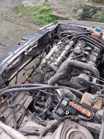

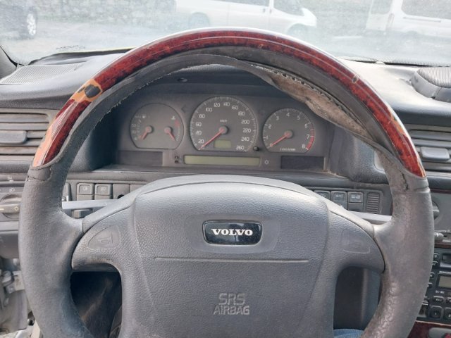

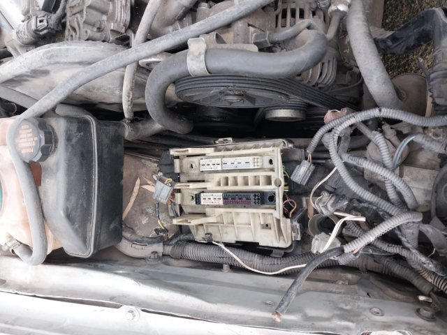

1386606333_WhatsAppImage2022-12-06at14_30_56.jpeg.0aeb877011920a335470395b54f6af9a.jpeg2120306942_WhatsAppImage2022-12-06at14_30.56(3).jpeg.4a1a3354d61b44368b943eb70836e82c.jpeg1330796946_WhatsAppImage2022-12-06at14_30.56(2).jpeg.cc46e5995915a6999927703298f1b61a.jpeg2050099007_WhatsAppImage2022-12-06at14_30.56(1).jpeg.31b8c2db9f5046d5e652251732f91a93.jpeg872435815_WhatsAppImage2022-12-06at14_30_55.jpeg.2b9f355885d789090554e0f51c0b2039.jpeg1878850113_WhatsAppImage2022-12-06at14_30.55(4).jpeg.f849b28ec8ddf6441ede52030add8407.jpeg626378774_WhatsAppImage2022-12-06at14_30.55(3).jpeg.d746d47075a9e76cab66bdf2c913c301.jpeg1049094514_WhatsAppImage2022-12-06at14_30.55(2).jpeg.d4851ef3cd5b367dfc7c4ed93a774aa7.jpeg299954400_WhatsAppImage2022-12-06at14_30.55(1).jpeg.bf757d82f0e36a5837f3bb9b26da1863.jpeg1846877529_WhatsAppImage2022-12-06at14_30_54.jpeg.0661d316a7471a3ca685e14eeebaf0c1.jpeg194358487_WhatsAppImage2022-12-06at14_30.54(5).jpeg.712c3109e56d7468e65287cdc082a60b.jpeg1971127569_WhatsAppImage2022-12-06at14_30.54(4).jpeg.9f8ff69086efd4f0e0e391a7c0c1fdaf.jpeg1873781686_WhatsAppImage2022-12-06at14_30.54(3).jpeg.0e65dc2a45e404db52d483b58293fd04.jpeg791824320_WhatsAppImage2022-12-06at14_30.54(2).jpeg.161b3312ab017730269cefacbcceebfb.jpeg1727230231_WhatsAppImage2022-12-06at14_30.54(1).jpeg.017efe2af55368d48c24e99d2d829cc8.jpeg902970394_WhatsAppImage2022-12-06at14_30_33.jpeg.d0be2521625564abed112c1392a8bd88.jpeg1871520215_WhatsAppImage2022-12-06at14_30.33(1).jpeg.28dd9d05114165f1f806efd096a373c1.jpeg1419182965_WhatsAppImage2022-12-06at14_30_32.jpeg.0eb81bd7b3a5a5436efbc90c0c1053f1.jpeg1990454332_WhatsAppImage2022-12-06at14_30.32(3).jpeg.81a0b6829cae5c33163ba322c87d2373.jpeg1426470521_WhatsAppImage2022-12-06at14_30.32(2).jpeg.d0b9ce6ac7f03c2136a2e3360fdd6372.jpeg1881528761_WhatsAppImage2022-12-06at14_30.32(1).jpeg.910c588e797d6fcd4b01bf504ad570ea.jpeg460170650_WhatsAppImage2022-12-06at14_30_31.jpeg.f6a708d997c6a851862ea713b19b79cc.jpeg460842143_WhatsAppImage2022-12-06at14_30_30.jpeg.2e104fad4093610c81e692915873a1e4.jpeg903722248_WhatsAppImage2022-12-06at14_30_30(5).jpeg.25cbf1779e1b664ea0a30ec0e5037135.jpeg415995719_WhatsAppImage2022-12-06at14_30_30(4).jpeg.acdc58ac3565963cc5c0f7fd681cb1eb.jpeg180975934_WhatsAppImage2022-12-06at14_30_30(3).jpeg.6b12d9dd1f164b791db81a71a55e63f0.jpeg1438570005_WhatsAppImage2022-12-06at14_30_30(2).jpeg.b711519c1cde456914dc60b403a9ebe3.jpeg140403898_WhatsAppImage2022-12-06at14_30_30(1).jpeg.f4f98bff130cf44609b3103a70d804f7.jpeg813040900_WhatsAppImage2022-12-06at14_30_29.jpeg.2807ca7902e92334d25b5357e4a9f2ab.jpeg2045498257_WhatsAppImage2022-12-06at14_30.29(3).jpeg.75b5efdda184b6eac196812a091b9150.jpeg2002531281_WhatsAppImage2022-12-06at14_30.29(2).jpeg.825221349360d4b7d9f00a986ff0da57.jpeg1369659321_WhatsAppImage2022-12-06at14_30.29(1).jpeg.b107989df2d2a62e3b3e9fbec6c9fed4.jpeg662589788_WhatsAppImage2022-12-06at14_30_28.jpeg.9651787737c8f09b9e2713f4d80b04b9.jpeg2106032889_WhatsAppImage2022-12-06at14_30.28(3).jpeg.834dcf25f75af671daabf7b3d8496aef.jpeg536381737_WhatsAppImage2022-12-06at14_30.28(2).jpeg.c1003983abcb605efeba787455aabf0a.jpeg1956719688_WhatsAppImage2022-12-06at14_30.28(1).jpeg.80fae5cfd5e552d84d2f79501d0e61bf.jpeg2122627654_WhatsAppImage2022-12-06at14_30_27.jpeg.d4f00b941bf423d019d526394bb50560.jpeg1418911798_WhatsAppImage2022-12-06at14_30.27(5).jpeg.a2bdf3b4b7e89465f9ad714e84680a43.jpeg2082240645_WhatsAppImage2022-12-06at14_30.27(4).jpeg.b2334e7abf88d88c61682e72ffcc54eb.jpeg1318898254_WhatsAppImage2022-12-06at14_30.27(3).jpeg.cb37c01471564f826ae2f1d71f8897c3.jpeg1391313939_WhatsAppImage2022-12-06at14_30.27(2).jpeg.8e55188d328705178e1ce0d7b0e4782e.jpeg474116919_WhatsAppImage2022-12-06at14_30.27(1).jpeg.5e5de0564d48101824a646631b279767.jpeg557067433_WhatsAppImage2022-12-06at14_30_26.jpeg.0658aec133e1f2ccc648a84980dd8e31.jpeg281916980_WhatsAppImage2022-12-06at14_30.26(2).jpeg.cc6077cec04431dc2655f44ea4ca836a.jpeg1883613141_WhatsAppImage2022-12-06at14_30.26(1).jpeg.7faf562eee02907cfc1084ab3d422bdb.jpeg

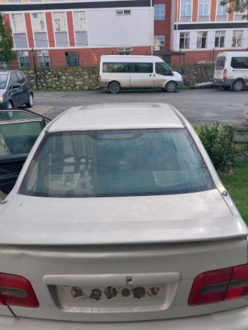

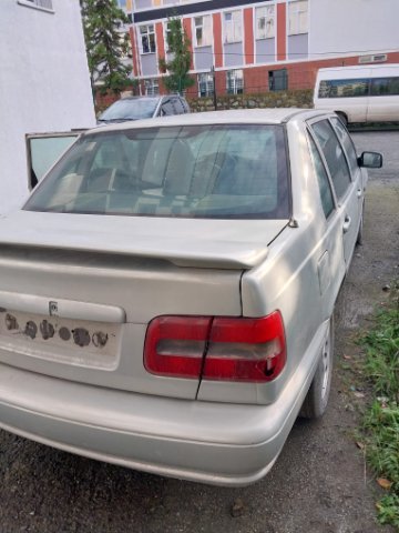

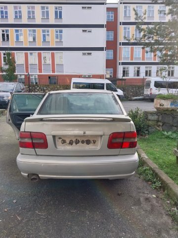

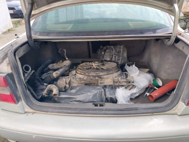

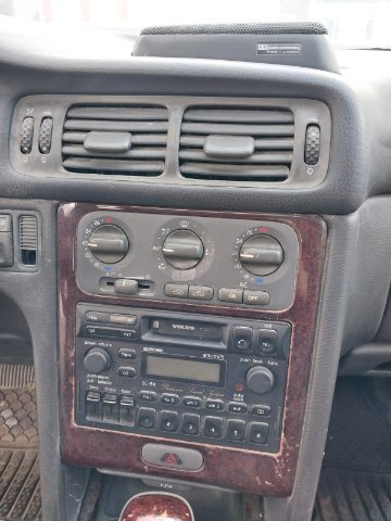

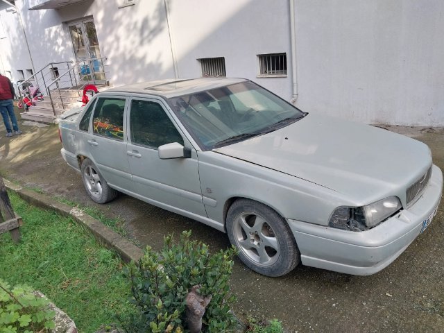

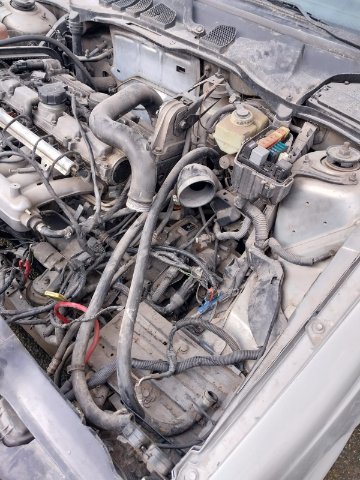

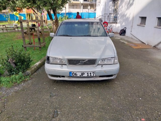

Beyinlerin çıplak oluşunu saymazsak radyatörler ve tavan döşemesi haricinde eksik bir şey yok gibi....

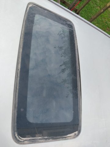

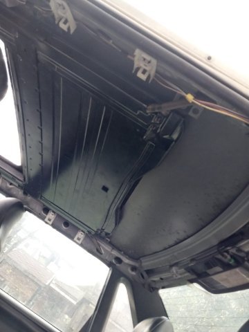

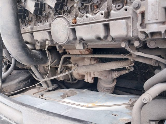

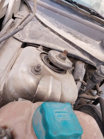

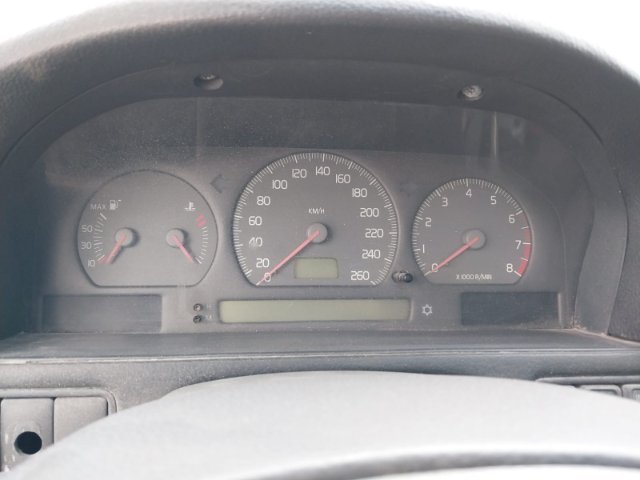

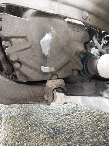

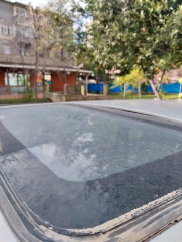

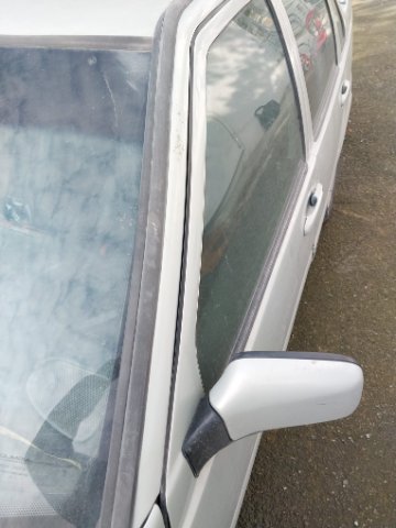

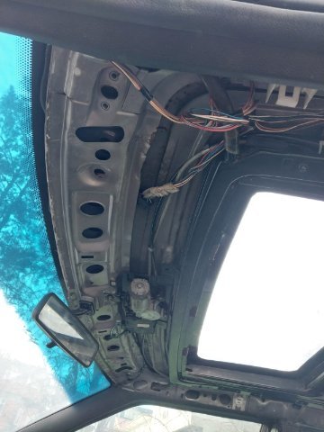

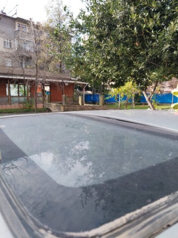

İncelediğimden anladığım kadarıyla sürücü tarafı çamurluk-kapı civarından aldığı hasar sonucu tavan da kasılıp sunroofu patlatıyor sunroof kendi camını bulamamışlar normal düz cam kesip koymuşlar tavan bombeli, sunroof düz olduğundan arada boşluk var. Tavan da yer yer çektirmeler düzeltmeler yapılmış , tavan döşemesi de muhtemelen o işlemler sırasında geri takılmadı. Şaselerde ucları dahil bir işlem yok, Hasar kaydı yok kaza sonrası ucuza toplanmaya çalışılmış gibi tahminimce kaput çamurluk ve sürücü kapısı değişmiş. Kapının kendi direğinde dışa bombe var kapı tam oturmuyor yarım cm açıklık var her yağmurda su alır halde. sürücü tarafı ön tekerin havası yoktu bugün şişirdim ön iki teker de hafitfen içe dönük duruyor. Amorsiör kulelerinde anormallik var normal mi anlamadım ama bana normal gelmediler. Motor şanzuman tarafından beşiğe oturmuş halde dikkatli bakarsanız fotoda da düşük duruyor. ön ve arkada beşik ve motor arasında hidrolikli kulaklar var kulak patlak olunca böyle düşer mi bilmiyorum ama benim tahminim bu araç kazadan sonra hiç kullanılamadı çünkü günlük kullanıma engel olabilecek kaza izleri halen duruyor; Sunroof ve kapıdan su alma. ön tekerlerin içe dönük oluşu, şanzuman tarafından motorun beşiğe oturmuş oluşu....
Sadece elektronik arızalı diye aldığım bu araç üzerinde elektronikten ziyade kaza sonrası mekanik aksam eksikliklerini de toparlamaya dönecek...

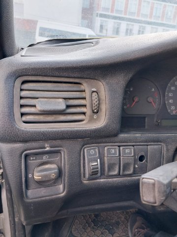

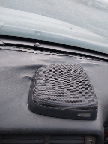

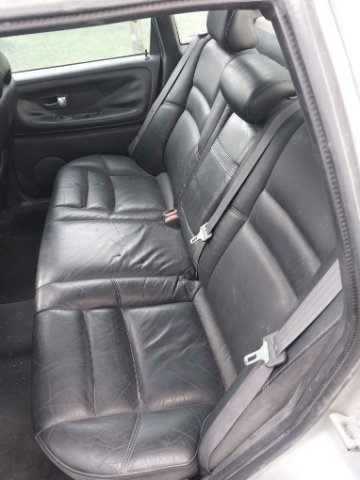

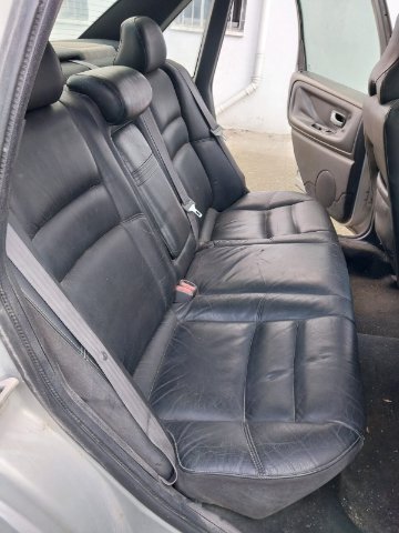

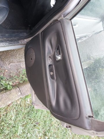

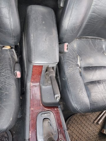

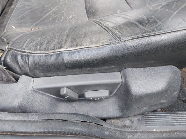

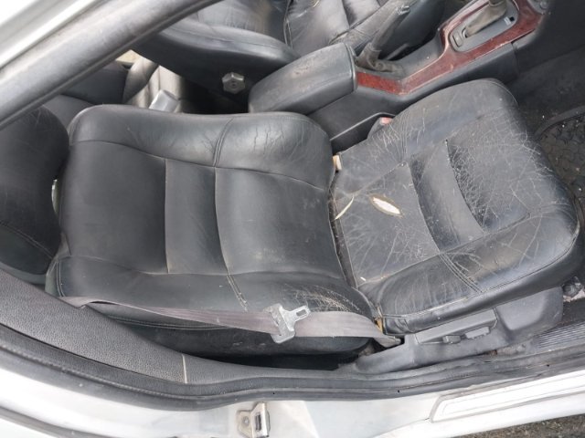

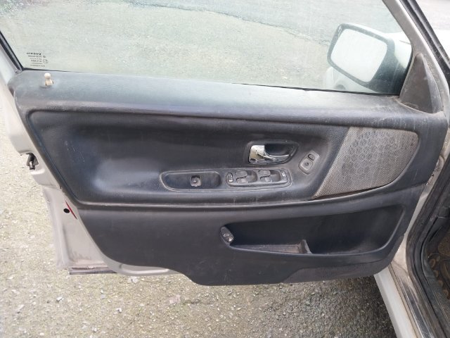

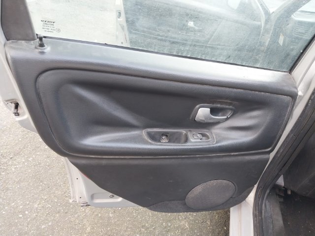

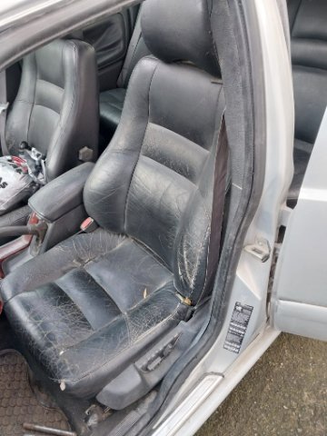

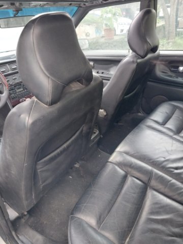

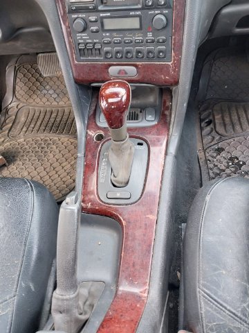

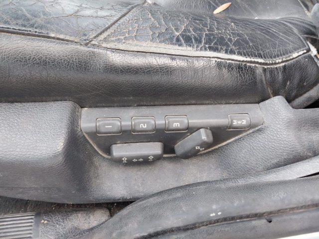

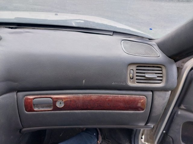

İçerde eksik parça olmamakla birlikte zamanında torpido kaplamasının üzerinde bir kaplama daha yapılmış  o da sonradan kalkmış. yenilenecek. Yaşına göre kabul edilebilir ön iki koltuk ve kapı döşemelerinde deri deformeleri var yenilenecek.
Henüz akü takmadım km kaç bilmiyorum. Yağ dolum kapağından içeri baktığımda yeni rektefe olmuş gibi parlıyor yağ izi kurum vs. hiç bir şey yok

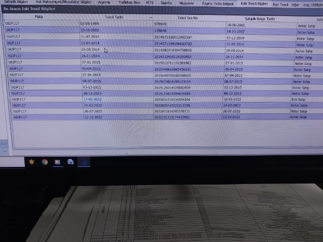

Bu da aracın eski tescil bilgileri muhtemelen yedieminde uzun süre yatma konusu yok (daha öncesinde yanlış yorumlamışım) ama kazayı 2014 de yapmış gibi ondan sonra sürekli satış görmüş.

arabanın içi ne kadar kaliteli ya maşallah bayılıyorum bu model yıllarındaki deri döşemelere
Erdem Hakkı Bağama
maliyeti 50 bin altında gibi bir rakam mıydı
Biraz üstünde. Zarar ettirmez ama tahminimden fazla uğraşcam.
Ali Gök yazdı:
İçi seni yakar dışı beni :)
sunroof basit ama uğraştırıcı bir detay, torpido eksiksiz olması iyi.
Amortisör kuleleri değişince tekerler düzelebilir..
şasede düzeltme yapılmadığı için olaibilir o haller, taban katlanmıştır, kapıdaki açıklıkta o yüzden olabilir.
Fordu bitirince garaja çekip altına üstüne iyice bakacam şimdilik beklemede ama kapıdaki aralık tamamen kapıdan dolayı. diğer ön kapı ile karşılaştırdım. sürücü kapısının kendi direğinde bombe var kupa direği düzgün.

O sunroof neredne kaça bulunacak ben merak ediyorum.

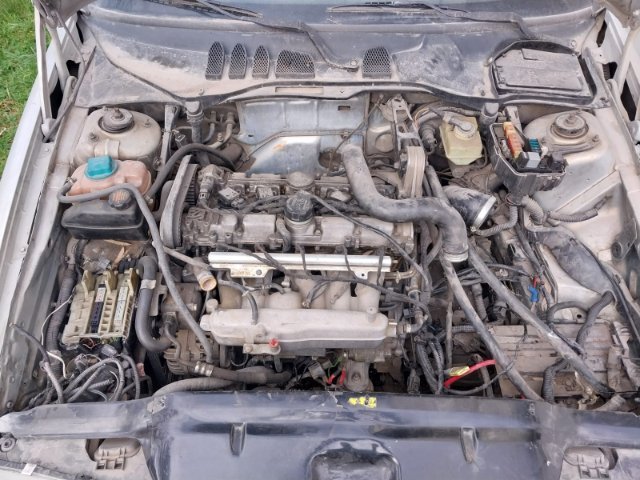

Motor bölümünde kesilmiş kablolar var. Oradan kesilip alınan ne ?
Tavan döşemesi nasıl nereden kaça bulunacak. ciddi sorun.
Motor kulakları nereden bulunacak. Araç Volvo ve çok satılan bir model de değil..

Aklıma gelen :  Tavan döşemesi uygun bulunabilirse, sunroof kapatılarak sorun çözülebilir.
Çıkma olarak farklı illerde bütün eksiklerini buldum parça tedarikte sıkıntı yok.
Tüm elektronik kablo şemalarını 15 dolara dün gece satın aldım. Motor bölümü kesilmiş kablolar hangi renk kablo nereye gidecekti hepsi mevcut. Zevkle toplayacam. Ama şu an fordla meşgulum.
